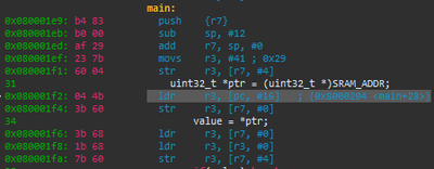

I have following code snippet, when I compile it with -O0 optimization level it gives below assembly code and I can observe value address on Expression window. But when I compile it with -O3 optimization level I couldn't observe address of value.
Where is the storing location of value when compiled it with -O3 ?

Disassembly :
-O0 optimization :
-O3 optimization :

Make value volatile, otherwise optimizer optimizes it away entirely.

value is simply held in register r3, and stored within the local stack frame [r7+4] or [sp+4]
