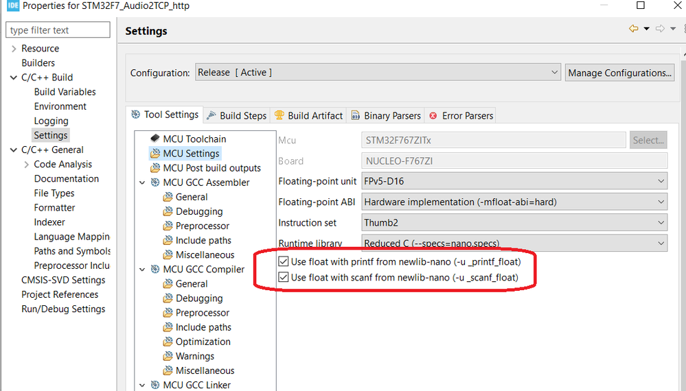

Hai, I am using stm32h743zi nucleo board in that I am send and receiving float via UART using sprintf but facing hard fault error while running , help me to sort this issue would be appreciated.

Second, maybe you need to set these checkboxes in the project settings:
2021-11-24 6:57 AM
Also note that printf/sprintf (and maybe sscanf, not sure) use the heap and a failed allocation can cause a crash.

Thanks,I have this done in my code still I am facing the same issue.
