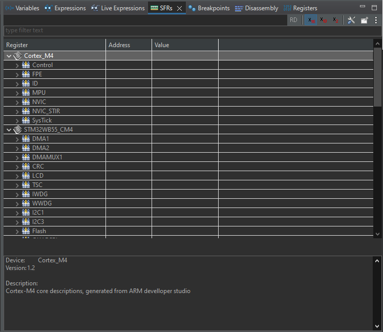

To watch the IP register, the STM32CubeIDE provide a specific view for this purpose called SFRs:
I hope this answer solve your question. If yes, please mark the answer as a Best Answer.
Semer.

I am familiar with SFR window. The problem I have is the fact, that this view doesn't show changing of registers values during runtime (values update only on "pause").
