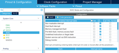

MM..1
Chief III
Maybe here you can off on or simply exclude it file from build and use own.
