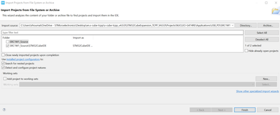

Hello @alw and welcome to the ST Community :smiling_face_with_smiling_eyes:.
I suggest you to follow those steps:
- Select File-> Open Projects From File System...
- On the import Source: select the Source of your project (for example : "Desktop\en.x-cube-tcpp\x-cube-tcpp_v4.0.0\STM32CubeExpansion_TCPP_V4.0.0\Projects\NUCLEO-G474RE\Applications\USB_PD\SRC1M1_Source").
- Select Just the STM32CubeIDE project as shown here:
- Click on Finish.
- The Project is generated, you can Now compile it.

Thanks very much, it all works ok now
