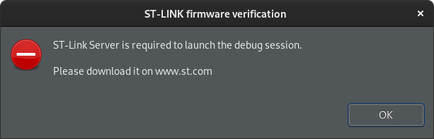

Installing STM32CubeIDE on OpenSuse Tumbleweed
‎2019-12-21 6:22 AM
Installing STM32CubeMx on OpenSuse Tumbleweed using
/st-stm32cubeide_1.1.0_4551_20191014_1140_amd64.rpm_bundle.s
is missing libusbx
sudo ./st-stm32cubeide_1.1.0_4551_20191014_1140_amd64.rpm_bundle.sh
[sudo] Passwort für root:
Creating directory st-stm32cubeide_1.1.0_4551_20191014_1140_amd64.rpm_bundle.sh.root
Verifying archive integrity... All good.
Uncompressing STM32CubeIDE installer 100%
Verifying... ################################# [100%]
Preparing... ################################# [100%]
package segger-jlink-udev-rules-6.44c-4.noarch is already installed
error: Failed dependencies:
libusbx >= 1.0 is needed by st-stlink-server-1.2.0-3.amd64
package st-stlink-udev-rules-1.0.2-2.noarch is already installed
st-stlink-server is needed by st-stm32cubeide_1.1.0-1.1.0-4551_20191014_1140.x86_64
libusbx is not available for OpenSuse. On https://sourceforge.net/projects/libusbx/
SourceForge: libusbx is OBSOLETE and has been superseded by http://libusb.info
What can I do?

@hj​ I use OpenSUSE leap 15.1 and had the exact same problem as you with the rpm bundle.
I used STM32CubeIDE Generic Linux Installer instead and it worked without any problems.

libusbx is no more maintained. Waiting ST for upgrade st-link server
