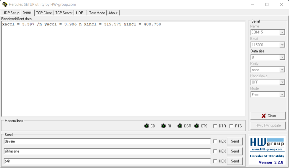

I use stm32cubeIDE
my code:
sprintf( mesaj, "xaccl = %3.3f /n ", xaccl );
HAL_UART_Transmit( &huart6, mesaj, sizeof(mesaj), HAL_MAX_DELAY );
how I can fix /n terminal problem?
thanks for answers

Use the proper escape character, ie \n

Might also point out that sprintf returns the length of the generated string, and sizeof() isn't suitable for strings.​

And use snprintf() instead of sprintf(). Friends don't let friends use sprintf().
