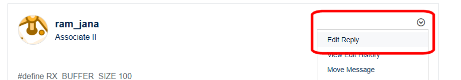

@KnarfB wrote:
 by using "insert code sample" blocks.
@ram_jana See How to insert source code for how to do that.
You can edit your post by clicking the little arrow at top-right:
You'll need to paste the code again from your editor because it's now lost all its indentation.
