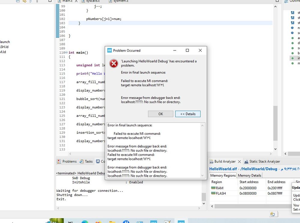

i am using a STMCubeIDE v1.11.2 with windows 10 when i creat a new project it is working if i closed the IDE and open it again the problem below occure
Error in final launch sequence:
Failed to execute MI command:
target remote localhost:٦١٢٣٤
Error message from debugger back end:
localhost:?????: No such file or directory.

Not clear why your system display hieroglyphs instead of numbers.
Not sure how well any of this is tested on foreign language versions of windows.
this is number is 61234
I changed the number system of the windows from arabic to english and it is working now
