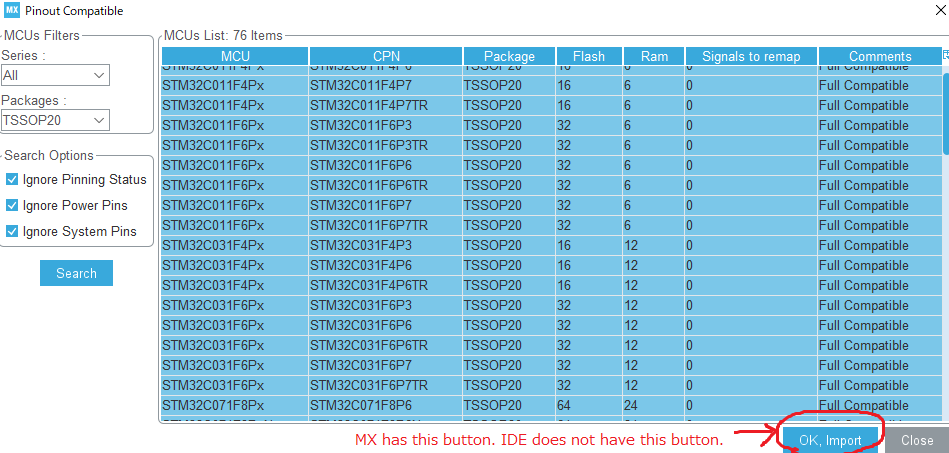

When I used CubeMX, MCU could be switched to select
[Pinout]→[List pinout compatible MCUs]→[OK, Import]
However, in case of CubeIDE, the [OK, Import] button is not appeared.
Is the "switch MCU function" deleted?
Thanks your help,
