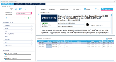

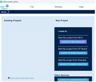

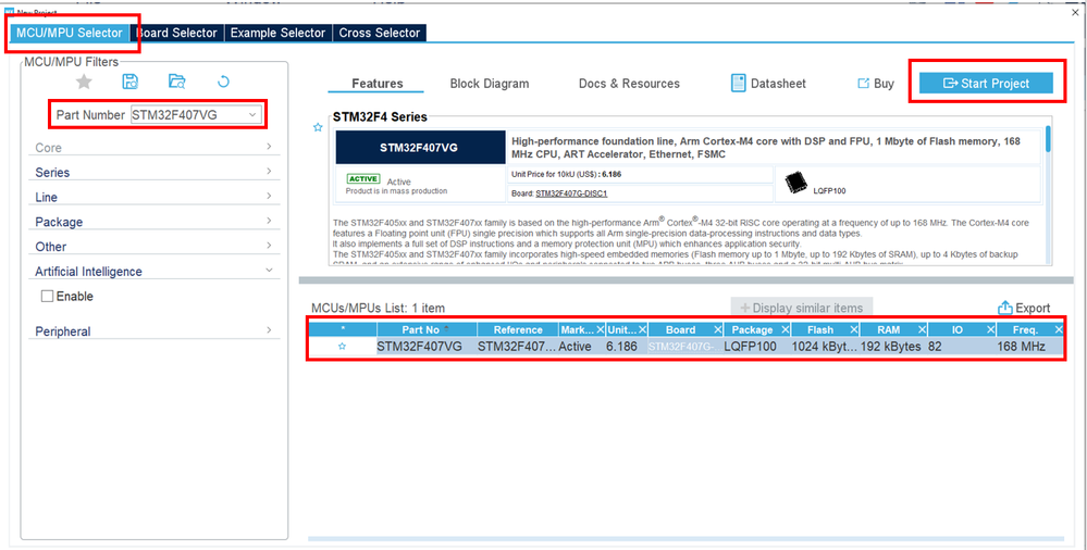

  • Step 1: Open STM32CubeMX and click the [ACCESS TO MCU SELECTOR] button.
  • Step 2: Enter the part number that you want to work on in the [Commercial Part Number] field. In this example we work on STM32F407VGTx. Select it, and then click on [Start Project].
A window opens as shown in the screenshot below:

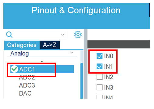

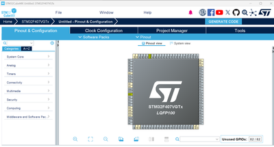

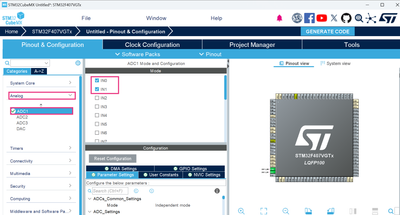

Add some peripherals and their associated configurations to our project. For example, we can add two ADC channels:
  • Step 3: Click on the [Analog] button, select ADC1, and select “IN0” and “IN1”.

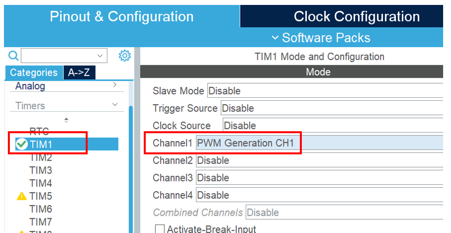

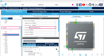

We also add a timer with a PWM output channel:
  • Step 4: Click on the Timers button, select TIM2, choose “PWR Generation CH1” for the Channel1 field.

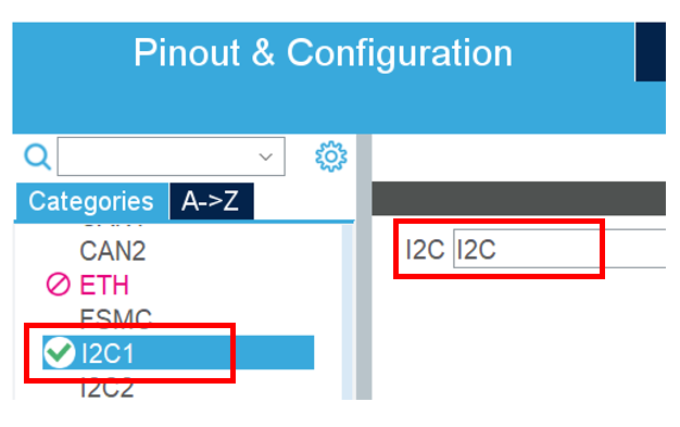

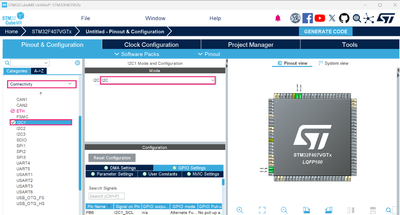

  • Step 5: Click on the [Connectivity] button, select I2C1, choose “I2C" for I2C field.

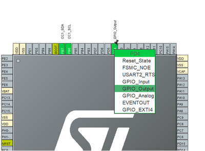

  • Step 6: Add a few GPIOs.

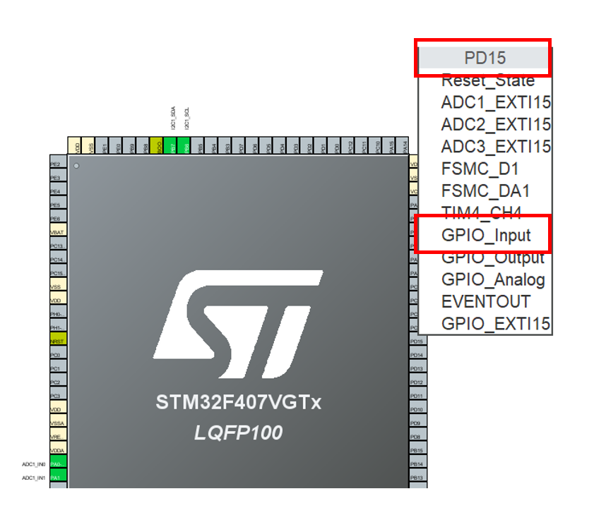

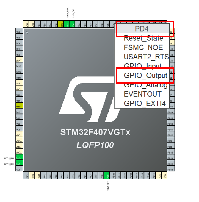

GPIO output: Click on PD4 and choose “GPIO_Output”

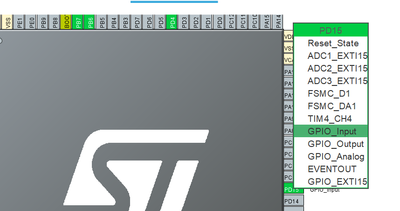

GPIO input: Click on PD15 and choose “GPIO_Input”

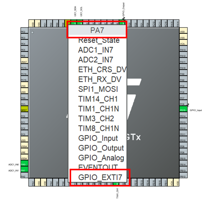

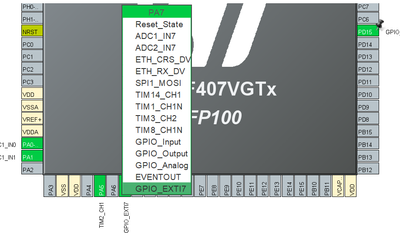

EXTI (external interrupt): Click on PA7 and choose “GPIO_EXTI7”

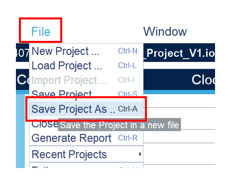

Now, let us save this example configuration:

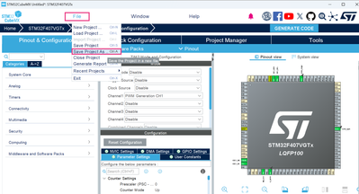

  • Step 7: Click on the [File] button located at the top and select [Save Project] with the name STM32F407_Project_V1.

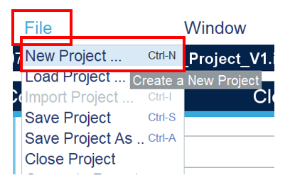

  • Step 8: Create a new project by clicking on the [File] button located at the top and select [New Project].

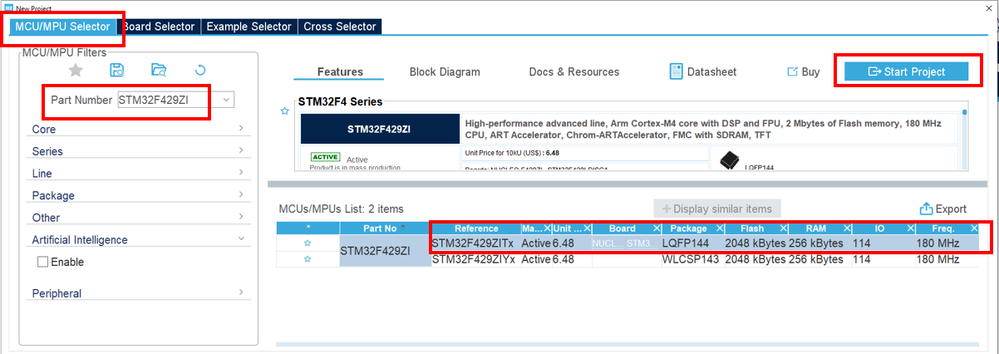

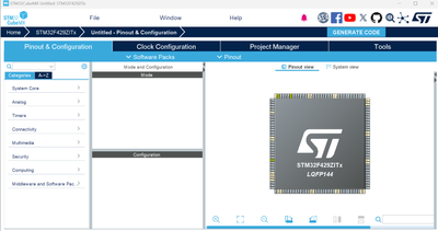

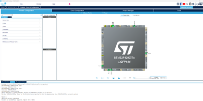

We select an STM32 belonging to the same series (STM32F4). As an example, you can select the STM32F429ZITx:
  • Step 9: Enter the part number that you want to work on in the Commercial Part Number field. In this example we work on the STM32F429ZITx, select it, and then click on [Start Project].

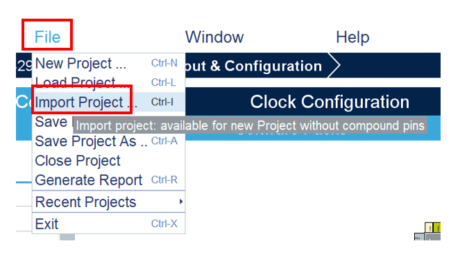

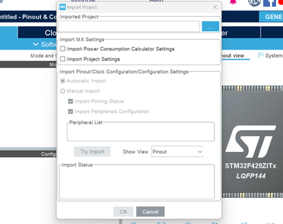

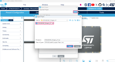

  • Step 10: Click on the [File] button located at the top and select [Import Project]:

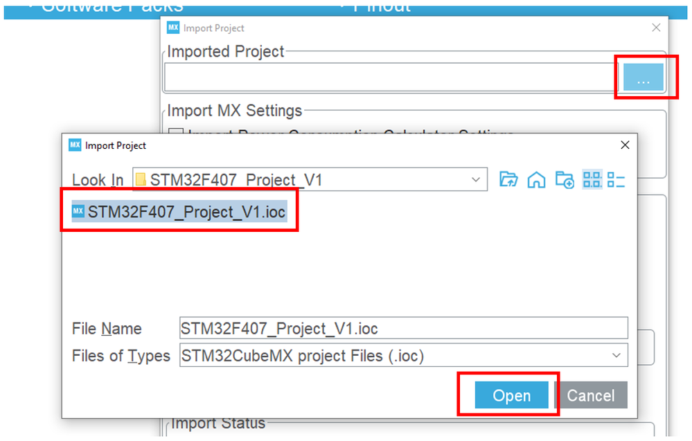

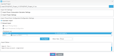

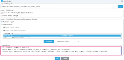

  • Step 11: Locate the project we previously created for the STM32F407 by clicking on the three dots located at the top, selecting the project, and click [Open].

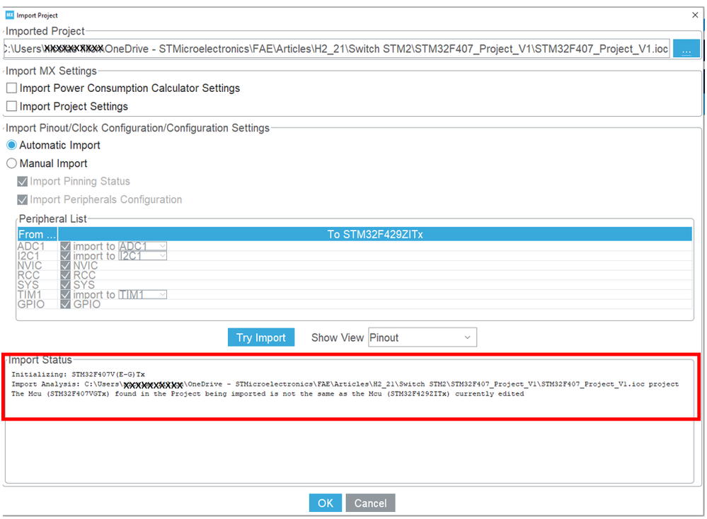

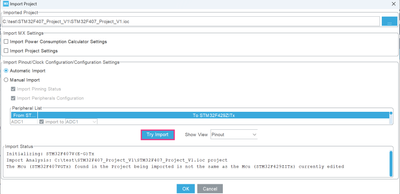

A window opens as shown in the screenshot below which contains an important remark:
This message indicates that the MCU (STM32F407VGTx) found in the project being imported is not the same as the MCU (STM32F429ZITx) currently edited.

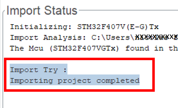

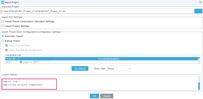

  • Step 12: Click on the [Try Import] button and see the status of the import operation.
The tool returns that the importing project is completed as shown in the screenshot:

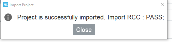

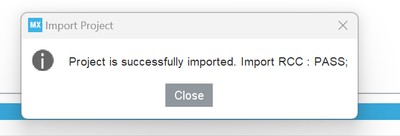

  • Step 13: Now, click on [OK] to import the project.

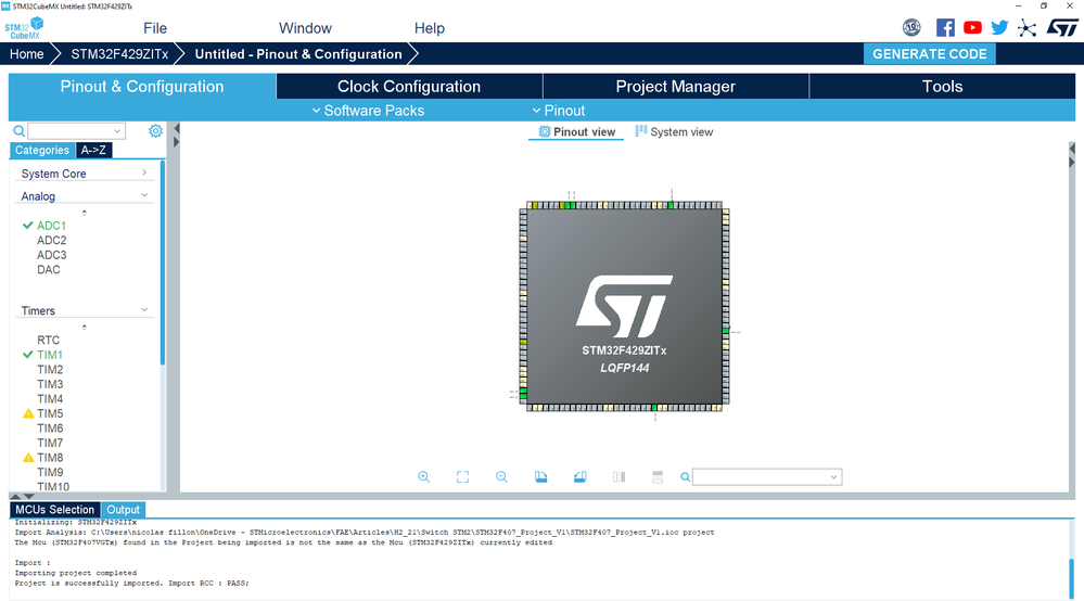

A pop-up is displayed indicating that the project has been successfully imported:
We have now completed the import of the configuration for the STM32F407 to the STM32F429:

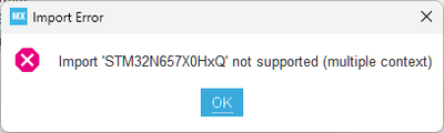

Where can I get details about a failed import? Background: I designed a system with the largest available derivate (STM32N657X0H3Q), now I want to find out, which is the smallest appropriate controller. So I create a new project, using a smaller one (i.e. STM32N645A0Hx) and try to import. I would expect a list of incompatibilities but only see this error message
