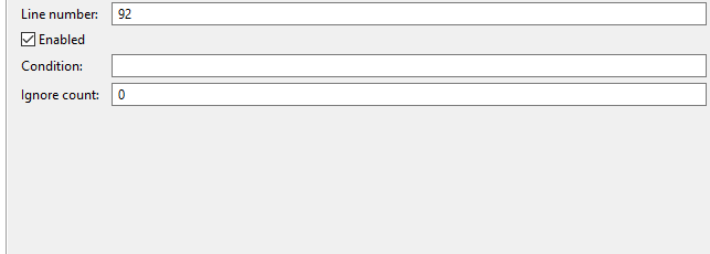

How to set conditional breakpoint in STM32Cube IDE? syntax?

I want to set the condition for breakpoint, so that when condition is true then breakpoint occurs.
In breakpoint properties -> common -> condition, you can set the condition.
I want to know the syntax to write the if condition for the same.
ZHan.2
April 18, 2023
It's a boolean expression in C/C++; For example, if you want this breakpoint breaks only when the global variable global_a is equal to 100, just input global_a == 100.
