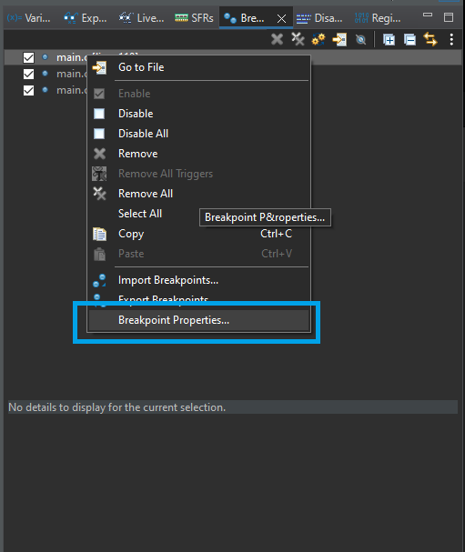

Hey hi Community !
I’m here because I didn’t found informations onto «fonction breakpoint» «event breakpoint» and «watchpoint» :
I work with STM32G071, write C and use GDB.
I want to configure a conditional breakpoint, that break when a variable is equal to a specific value. Is that possible ?
I tried with a Watchpoint, but it doesn’t work well.
Can you help me pls?
Thanks a lot !

Hello @PSimo.4​
In fact, such feature is implemented in STM32CubeIDE.

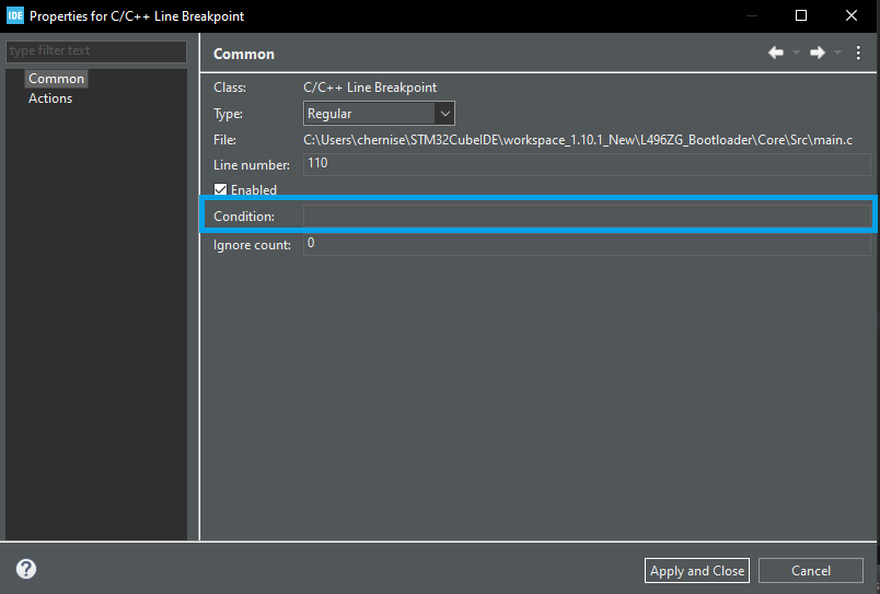

In the debugging view go to the Breakpoint view and right click on the breakpoint where you want to add a condition.
Open the Breakpoints Properties menu and add the stopping condition.

As Condition may I write « var == 5 » (if var is a correctly declared variable ?)
I saw Watchpoint with a similar interface, (with condition)
Is Watchpoint the same thing that a conditionnal breakpoint, but didn’t attached to a line ?
