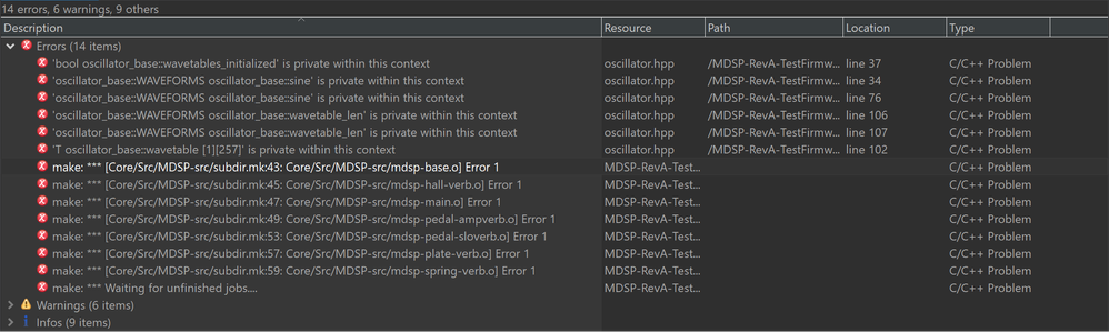

Hi, I am working on a project using STM32CubeIDE. I do development remotely and share work with my coworkers via github. Recently we ran into a bug where they were getting the following error after cloning and compiling a project on their end:
Stuff like this:
'bool oscillator_base::wavetables_initialized' is private within this context
oscillator.hpp /MDSP-RevA-TestFirmware/Core/Src/MDSP-src/dsp-blocks line 37 C/C++ Problem
This is extremely difficult to troubleshoot as it's simply not happening on my machine. Seems like some subtle difference in project settings that isn't getting copied over by git.
In this regard I have two questions:
1. Does this type of error point to any particular cause in project settings we should look at?
2. Is there a standard gitignore for STM32Cube projects? We'd like to have everything synced project wise such that if you run a clean/build you get the same output on any machine you clone to, but not copy unnecessary output files every time a new build is generated.
This is the oscillator.hpp and .cpp file where the error is supposedly originating:
