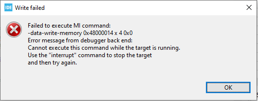

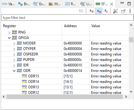

Hi. I can't read/change the SFR values while debugging in CubeIDE.
If I try to do that IDE throughs and error.
The only way to read/change values is by suspending the debugging session.
I remember this feature was there in CubeIDE or am I missing something?
I'm using STM32G474RE nucleo board.
Thanks

Hello Lalit,
The SFR values are only updated once the debug session is stopped. You are correct that you might remember this was sort of a feature earlier.
I will link to a post where my colleague Mattias answers the details surrounding this here.
I would suggest that you read through it and if you have any further questions then please let me know!
