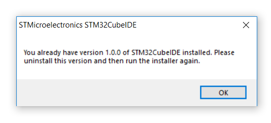

When I firsts Installed the STM32Cube IDE got all kind of error in paths and other stuff, so tried to uninstall it, the uinstallation was always freezing and I deleted the folders. Also, tried to delete some registers but could not find anything more..
So, when I try to install it again, I get this message.
What should I do to force it to install?
Also, I ve Atollic 9.3.0 installed and my current project is beeing developed on it.
- Labels:
STM32CubeIDE
‎2019-06-04 5:42 AM
Ethan Huang gave a great answer to this which I will just paste here:
- Delete CubeIDE installation folder manually (default: C:\ST\STM32CubeIDE_1.0.0)
- Run "regedit" to delete this key: HKEY_LOCAL_MACHINE\SOFTWARE\Wow6432Node\STMicroelectronics\STM32CubeIDE\1.0.0
