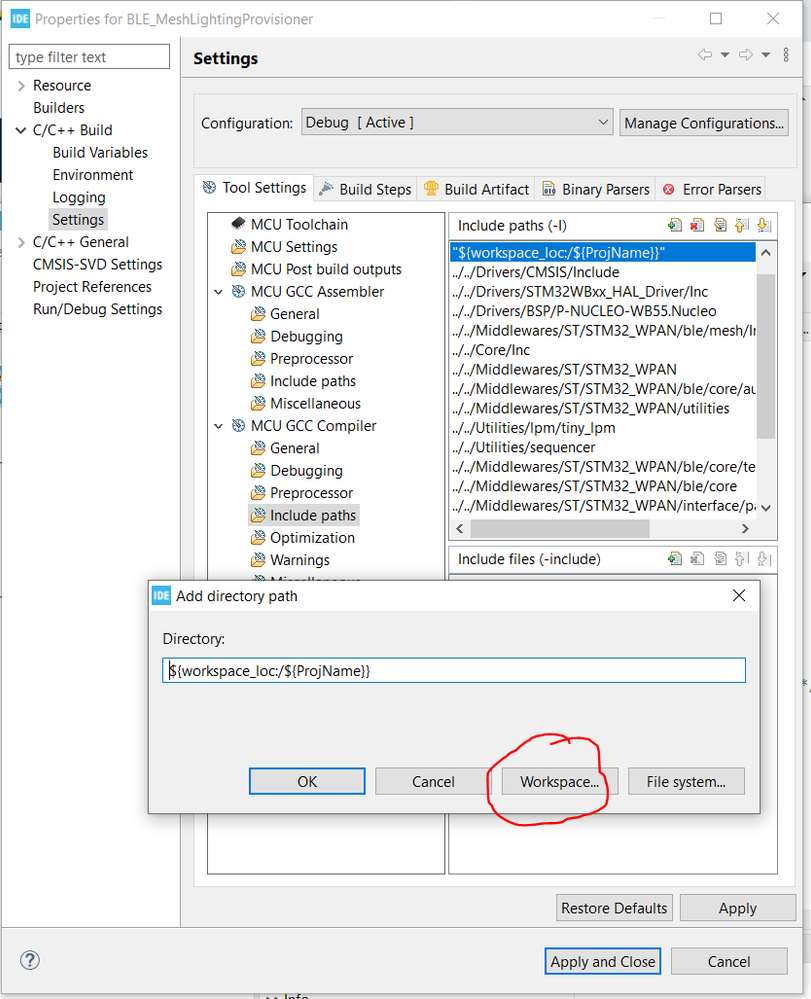

Include paths are be in project properties -> C/C++ Build -> Settings -> Tool Settings -> MCU G++ Compiler -> Include paths. If that doesn't fix it, make a new thread and show a screenshot of your include paths.

‎2022-02-05 9:35 AM
Yes this works ...
>Click >> Workspace
