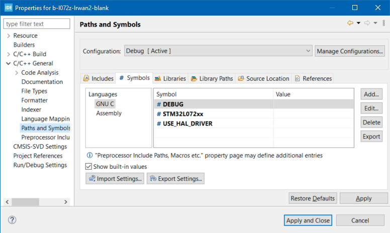

Why would you want to do that?
#include is precisely the mechanism to use to include a header file - that is its entire purpose & raison d'etre.
If you want symbols to be defined globally for the project, use the 'Paths and Symbols' in the Project settings:
