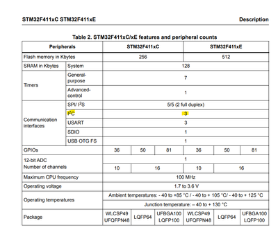

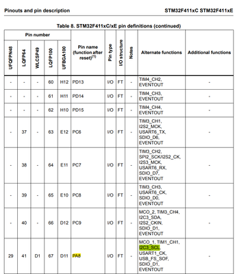

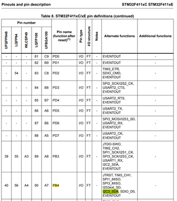

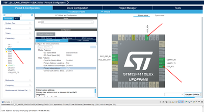

in cube mx (cube ide version Version: 1.19.0)   i can select i2c3 for STM32F411CEU6
bun can someone verity that this chip in ufqfpn48 support i2c3??
KDJEM.1
Hello @Lios ;
As mentioned in the datasheet, the STM32F411CEU6 device supports the I2C3.
Thank you.
Kaouthar
