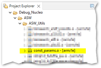

Yes the file exists albeit in sub folder.
This got me thinking that I need to qualify the object filename with a relative path:
  .cal_data :
    ./ASW/ASW_Utils/const_params.o(.rodata)

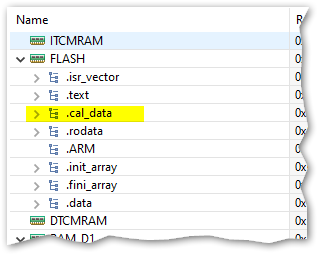

Now the linker completes its .elf output without error. However, the cal_data output section still does not appear.

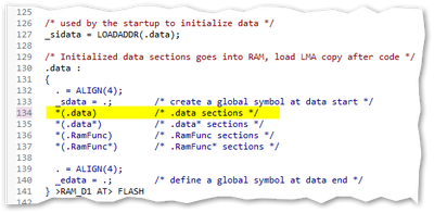

Next, I noticed there's an apparent duplication of most input section names in a typical .ld file, e.g. .data and .data*
Following the hint, I added a wildcard to .rodata even though there's no basis for doing so since the target section name (.rodata) in unambiguous.

Fortunately this now triggers the correct result:
The implication is that only a wildcard for the input section is effective and indeed that is born out by experiment. For example, commenting out line 134 here does precisely nothing:
So this begs the question why the wildcard for the input section name is mandatory or, put another way, when would the line on 134 above be effective? I guess it's not critical, just curious.
