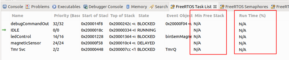

How to enable "Min Free Stack" and "Run Time (%)" in STM32CubeIDE?
  • February 16, 2022
  • 1 reply
  • 4971 views
I am trying to add more information in my debugging. And I found information about "Min Free Stack" and "Run Time (%)" is missing in "FreeRTOS Task List":
0693W00000JPyfKQAT.pngI googled this, and found something like this for example. but I couldn't find any explanation to do this by using "ioc" GUI.
My board is nucleo-f767zi.
If I have to define these two lines:
#define portCONFIGURE_TIMER_FOR_RUN_TIME_STATS() vConfigureTimerForRunTimeStats()
#define portGET_RUN_TIME_COUNTER_VALUE() vGetTimerForRunTimeStats()
how can I define vConfigureTimerForRunTimeStats() and vGetTimerForRunTimeStats() by combination of using ioc file and source file? Or is there any other way?

Hello @YoungKim​ ,
Min Free Stack column is disabled by default. To enable stack analysis use the Toggle Stack Checking toolbar button in the FreeRTOS Task List view toolbar.
Take a look at this document (section 6.2.3) : STM32CubeIDE user guide - User manual
This might help you.
