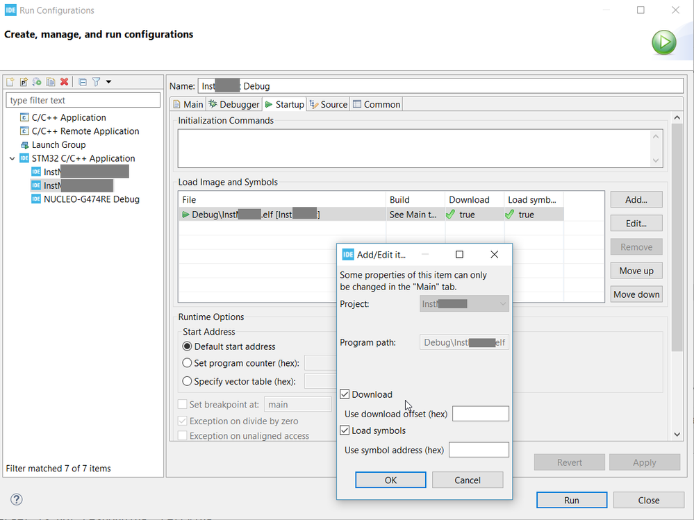

how to debug the program in StmCubeIDE without flashing the controller every time? Just debug. Programmer STLINK v2, microcontroller STM32F769. Are there any options to disable flashing on start debug?

Try to edit the debug configuration to not flash on startup.
Debug configurations... -> Startup tab -> select the one you're using -> Edit -> uncheck "Download"

strange... if in debug mode, force a reset and run when ready. Unless reverse engineering?
PColo.1
it was so simple... How could I not see the Download column ... This is not reverse engineering, some settings are stored in the flash and are changed by the user, they cannot be overwritten during debugging.
I'm using STM32CubeIDE Version: 1.10.1 , I can not find the option you mentioned.
Could you please attach a screenshot?

I guess it is this one?
