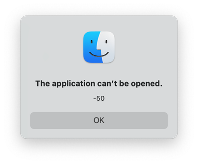

As an aside, at the end of the Example import I get the following (not very informative) error (which I ignore).
