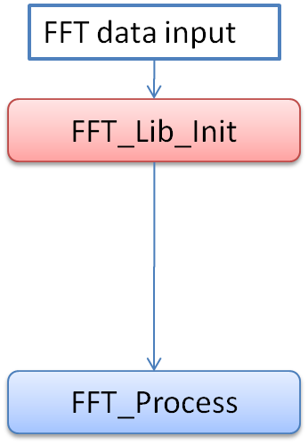

We have project based on the AMICAM1\UltrasoundFFT project and would like add algorithms in it.
There are two major thread in the proect as below.

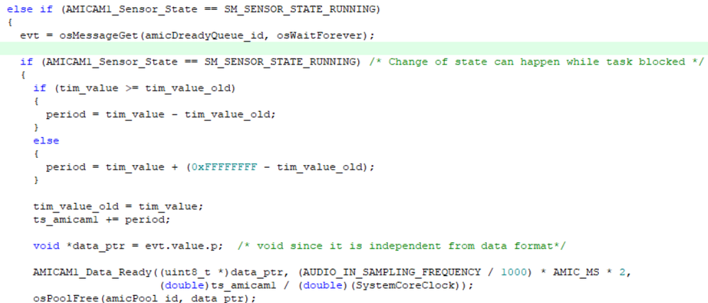

_legacyfs_online_stmicro_images_0693W00000bix5VQAQ.pngFirst I use simulation data(different frequency tone) instead of real ADC data to test FFT algorithm in the AMICAM1\UltrasoundFFT project.

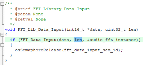

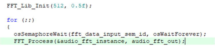

The following code tell MCU to get sensor data before FFT algorithm(512 point) in AMICAM1_Thread.

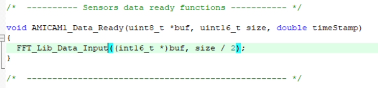

_legacyfs_online_stmicro_images_0693W00000bix14QAA.pngHow to use simulation signal to replace these real ADC data in the function below.
_legacyfs_online_stmicro_images_0693W00000bix3yQAA.pngBest regards,
