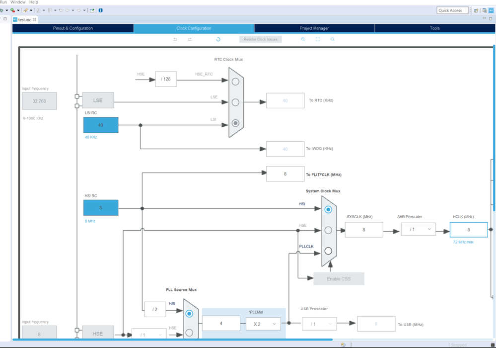

I have Accessability settings set up in Windows but CubeIDE seems to ignore them so the text is too small to read. Clock Configuration is scaled to fit in the page with no scrollbars whilst Project Manager uses about 1/16 of the available space
Ah got it. Zoom and scrolling doesn't work if you have window maximized, but does if you set it to resizable. That's a bug.

Have you tried CTRL+mousewheel ?
Yes. The lack of scrollbars seems to indicate they have been disabled in the sourcecode
0690X00000BwkARQAZ.pngStrange, I have STM32CubeIde 1.2.0 on Win10, and I can see scrollbars and can zoom.
Agreed. It used to work on this computer but I uploaded the latest version yesterday and it doesn't now.
Even more interestingly, if I set zoom in, then set back to maximized, horizontal scrolling and zoom stops working, but vertical scrolling still functions. But when I try a second time, this time zoom does work. Definitely weird !
