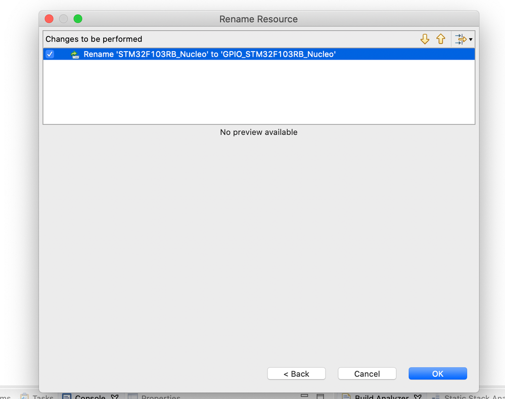

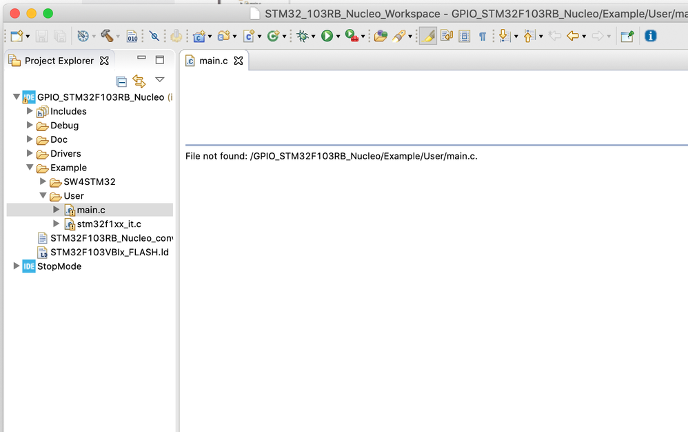

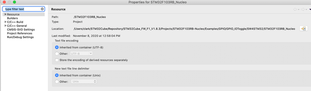

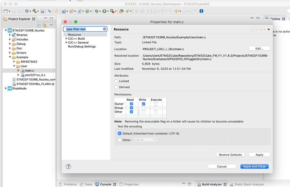

Here is my project path immediately after successfully importing. Please note that the path is pointing to the MCU Software Package repository. Then, as soon as I rename, the repository is damaged and I have to delete the F1 repo and reinstall it.
Properties of main.c after importing.
The preview screen for the rename command
The properties of main.c after rename
It's gone! We are doing either the import or the rename differently. I wonder if it is not the import. The import is leaving me editing the repo. I am not sure you are doing the same thing. I wish the import copied files into my workspace so I wasn't messing around in the repo.
