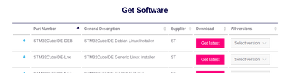

Visitor II
August 6, 2023
I ran into a similar problem on Ubuntu 23.04.  I don't have python 2.7 and don't really want to install it as this version is long dead.
There are two installers, avoid the debian one and try the generic linux one:
After unpacking/installing - I ran the `./stm32cubeide_wayland` option.  Not sure if this debian 12 is on wayland by default now but it works for my Ubuntu 23.04 install
