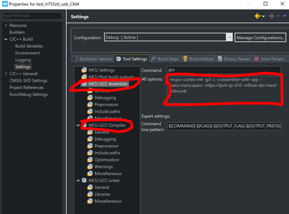

Hi, We are trying to move our (STM32F7xx) projects from Atollic TrueStudio 9.3.0 to the current STM32CubeIDE 1.6.1. I used the in built Import Atollic TrueSTUDIO project option. It converted it but now will not build.
  • May 4, 2021
  • 969 views
It says that our BOOTCODE (section in our linker file) has overflowed, see below
c:\st\stm32cubeide_1.6.0\stm32cubeide\plugins\com.st.stm32cube.ide.mcu.externaltools.gnu-tools-for-stm32.9-2020-q2-update.win32_1.5.0.202011040924\tools\arm-none-eabi\bin\ld.exe: P5000 Comms Bootloader.elf section `.text' will not fit in region `BOOTCODE'
c:\st\stm32cubeide_1.6.0\stm32cubeide\plugins\com.st.stm32cube.ide.mcu.externaltools.gnu-tools-for-stm32.9-2020-q2-update.win32_1.5.0.202011040924\tools\arm-none-eabi\bin\ld.exe: region `BOOTCODE' overflowed by 3888 bytes
When I set the ide to produce the assembler (.s) file I see that the gcc flags applied are slightly different . So my questions is where are the default gcc flags set for the STM32CubeIDE defined i.e. which file(s) and how can I change them? I have notice that the versions ar ethe same for the Atollic TrueSTUDIO except for isl version (0.15)

Right click project -> C/C++ Build -> Settings -> Tool settings
They are changed from within there.

Thanks for the reply. I have already looked in there and although it gives some of the flags it is not an exhaustive list.
below is the STM32CubeIDE .s output followed by the Atollic output both have been re formated for clarity.
