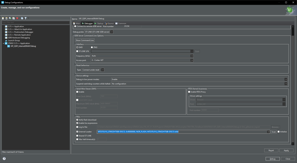

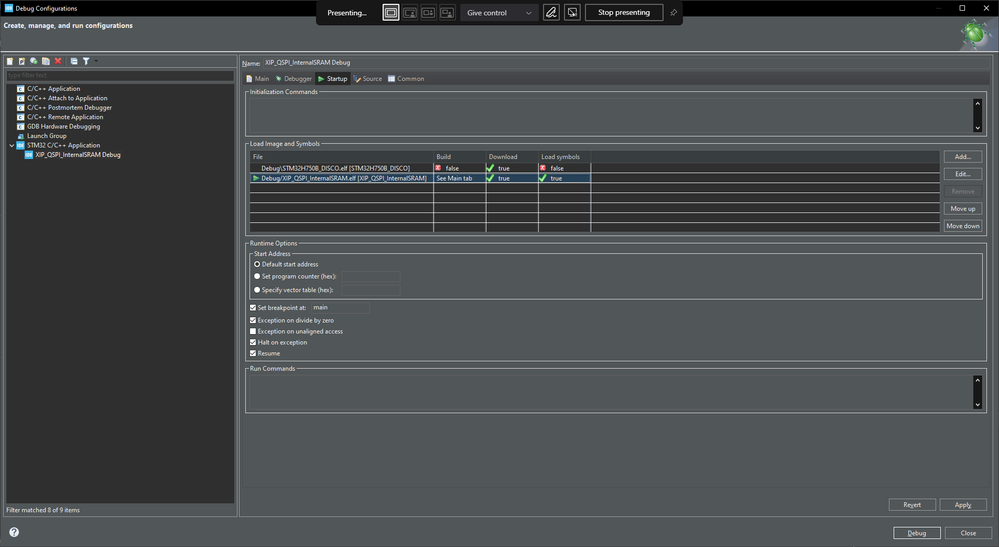

  • In the debug configuration and under [Startup] add the "ExtMem_Boot" download
  • Also in the debug configuration and under [Debugger] set the adequate external loader for your board
  • Start the debugging session

>>What is meant by Load project image?
Put the compiled output onto the board, using an External Loader if that code is built for the external memory (QSPI) device.
Debug configuration (external loader + add "ExtMem_Boot" under Startup) is only needed for the main program, so for "TIM_TimeBase", correct? So for the ExtMem_Boot Project I don't need to change some configuration setup?
I tried a the moment following, unfortunately without success:
1) Build "ExtMem_Boot" project
2) Run "TIM_TimeBase" project (with debug-config external loader + add "ExtMem_Boot" under Startup)
STM32CubeProgrammer is not mandoatory?
Thank you
EDIT:
Now it works, perfect, according 1) and 2)
