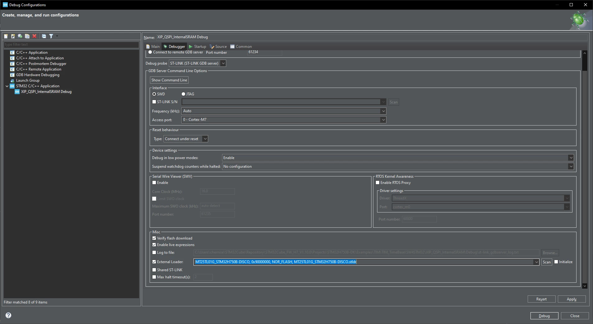

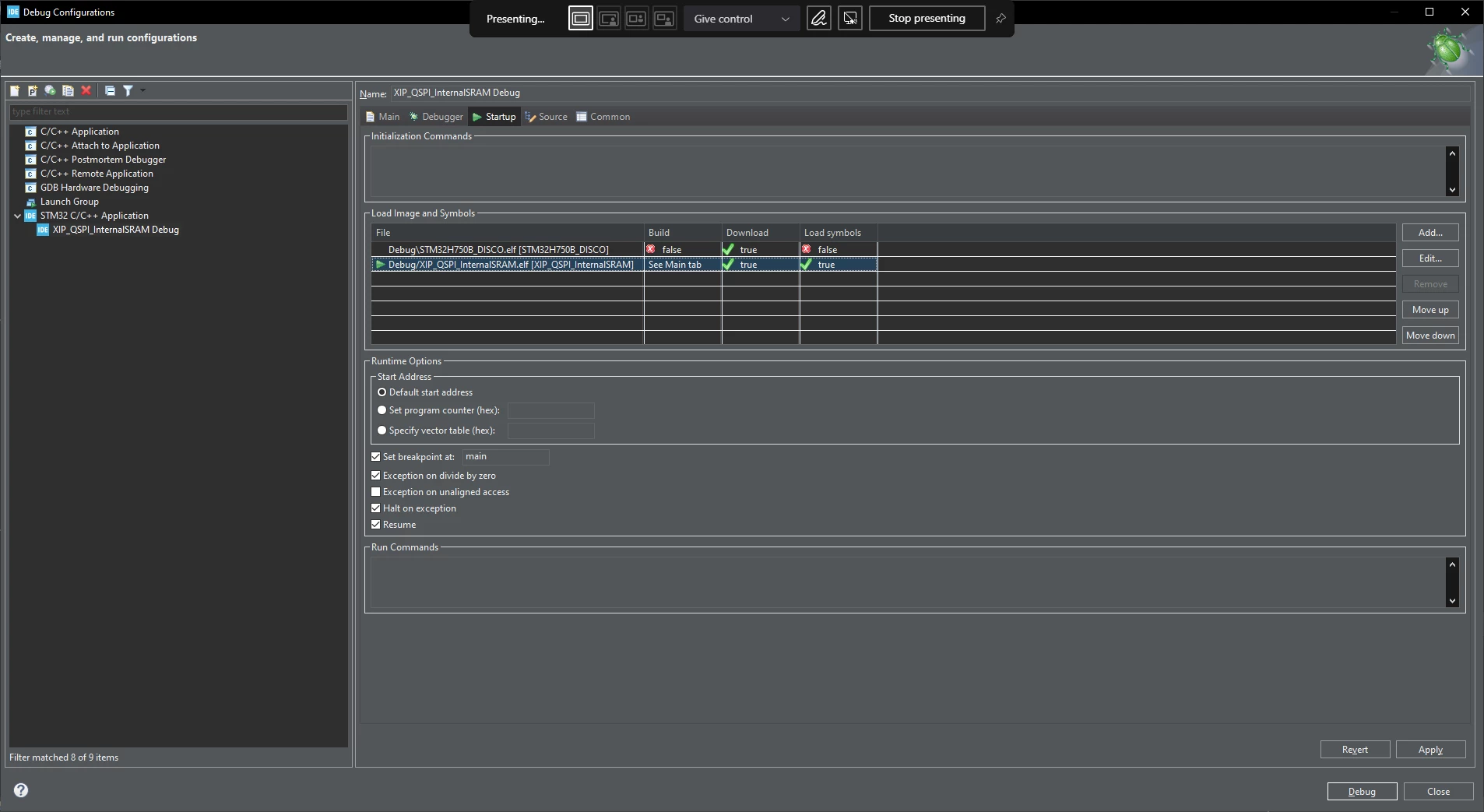

  • In the debug configuration and under [Startup] add the "ExtMem_Boot" download
  • Also in the debug configuration and under [Debugger] set the adequate external loader for your board
  • Start the debugging session
Debug configuration (external loader + add "ExtMem_Boot" under Startup) is only needed for the main program, so for "TIM_TimeBase", correct? So for the ExtMem_Boot Project I don't need to change some configuration setup?
I tried a the moment following, unfortunately without success:
1) Build "ExtMem_Boot" project
2) Run "TIM_TimeBase" project (with debug-config external loader + add "ExtMem_Boot" under Startup)
STM32CubeProgrammer is not mandoatory?
Thank you
EDIT:
Now it works, perfect, according 1) and 2)
