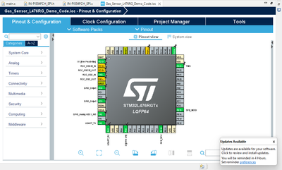

Having trouble interfacing RGB LED and Gas Sensor
  • December 27, 2023
  • 1 reply
  • 1866 views
Previously I posted on this forum as I was having trouble converting the gas sensor ADC value to voltage.
That problem has since been fixed, although I seem to be running into a new issue where my WS2812 RGB LED won't turn on, and the PuTTy monitor is outputting a incorrect value for my gas sensor. Here is the digikey link of the RGB LED that I am using: https://www.digikey.com/en/products/detail/inolux/IN-PI554FCH/7604874.
The code that I referenced for the RGB LEDs can be found from this Youtube video: https://www.youtube.com/watch?v=-3VKkTSAytM&t=1389s.
Here is a picture of my IOC setup, I have PB15 tied to the signal pin of my RGB LED and 5V and GND to it connected on my breadboard
Here is the SPI Header File code (The outer brackets are just to keep the code neat and not included in the actual SPI):
