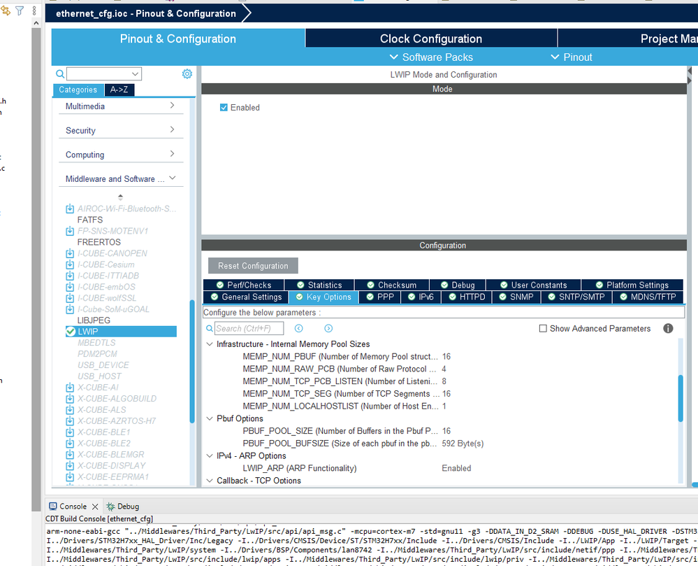

I  want to display the data on web interface with NUCLEO-H743ZI2 board without RTOS . Can anyone please guide me how to configure LWIP, ETH parameters settings in RMII mode and  MCU settings, pin configuration.Thank you in Advance!

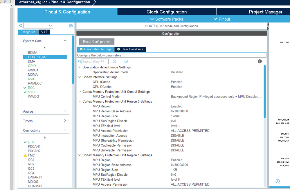

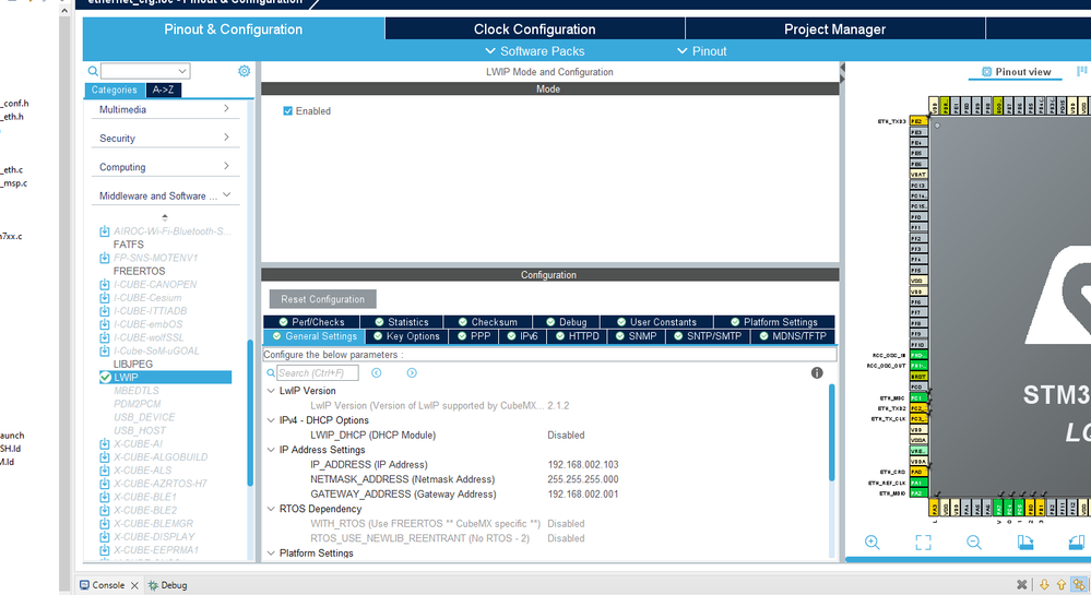

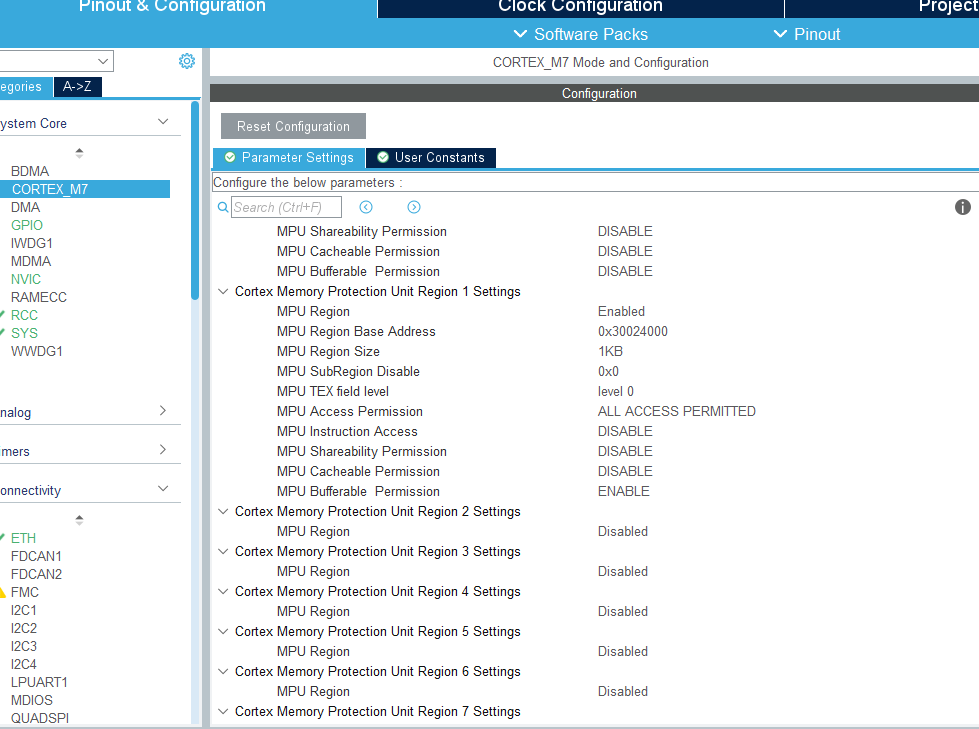

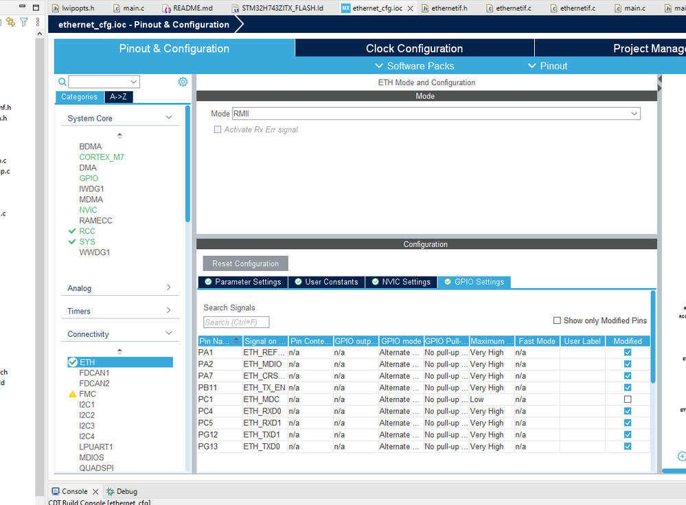

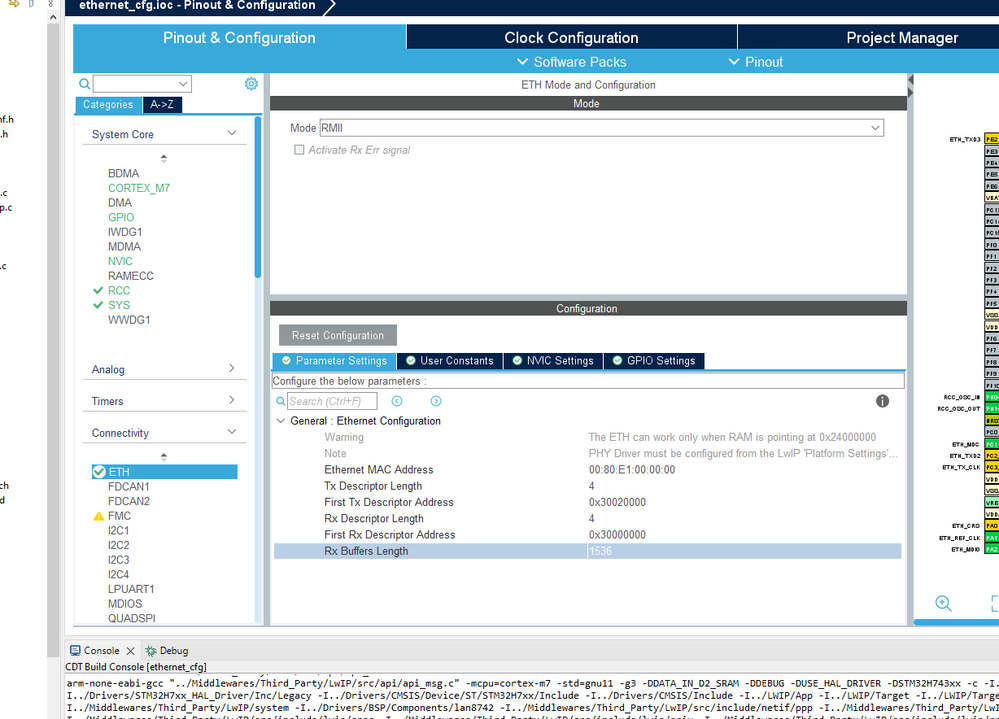

Please find thje above settings I did in cubeide. I called ethernetif_input() in main and trying to ping the IP addresss.The  ethernet connection is not established . I am getting error like host is unreachable. I tried all possible configuration of MCU, LWIP, ethernet settings from my side. Could You please guide me with correct settings
Ethernet is fairly difficult to program as there are a lot of components to it. Can you get an example project working?
Getting the CubeMX example LwIP_HTTP_Server_Netconn_RTOS to run should show basic functionality.
