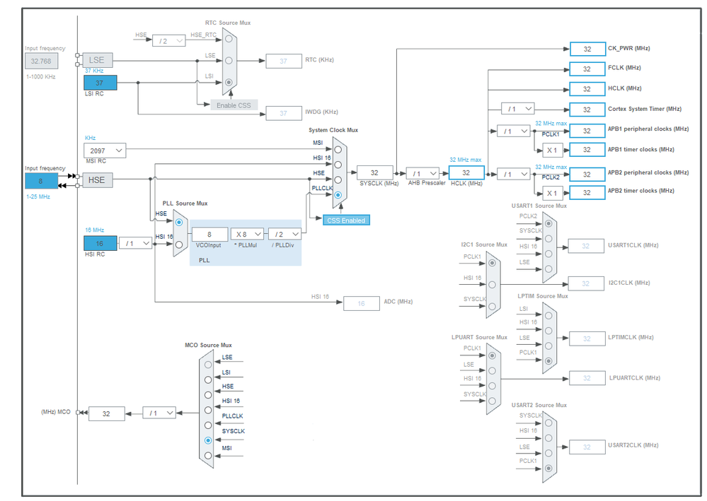

0693W00000KaZhCQAV.pngExternal XTAL works as expected. and configuration is as in the picture shown.

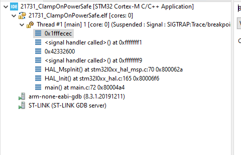

HSE starts and SysTickTimer is counting. it seems no SysTickInterrupt is thrown?
see picture below

OK Finally failure found.
reason was a floating level @boot0-Pin
many thanks for the help
BR's
Martin
So mapping of zero address space, and vector table.
Would explain the 0x1FFFxxxx address in the stack-dump
