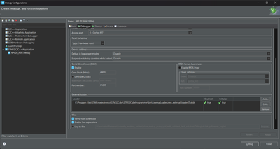

sorry for bothering you but know i know what is the problem when i enable  the external loader my code stuck here :

this is from freertos code and i ask chat gpt to make me some printfs on it to determine the problem and i commented the original code at the bottom of the funciton and this is what i get  when the external loader is
enabled :
Initial NVIC VTOR Address: 24000200
Initial MSP Value from Vector Table: 00000000
Invalid MSP value, manually setting to a safe address.
and if i disable the external loader the code runs normally and this is what i get from the printfs :
Initial NVIC VTOR Address: 08000000
Initial MSP Value from Vector Table: 24080000
Control Register Set to: 00000000
it seems like that when i enable the external loader it corrupts the stack pointer, and the vector table  even without uploading any code to the external flash ,thanks in advance.

i didn't use rtos in the code used to generate the external loader but i use it in the code that will be running in the external flash can i do that or not ? and when i enable  the external loader  in cube ide like the photo the problem above start to happen  when running the code even though i didn't specifiy any code to be uploded in external flash in linker script  yet and even the all the code sections is running from my stm32 h750 internal flash ,just enabling it dose this problem and i think the initialize option that marked in the photo is the reason because it make the startup code change the address of vector table or something don't know really why is this happening
