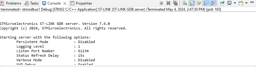

Is the gdb server set up? Did you try to start  the gdb server  manual? Does the Cube IDE command sequence point to the right places?
Probably there is also a log windows somewhere. Output there will help more than the pop-up.

Everything looks fine on the server side. it also follow command sequence to right places. can't find log windows
Dont see something in console output ?

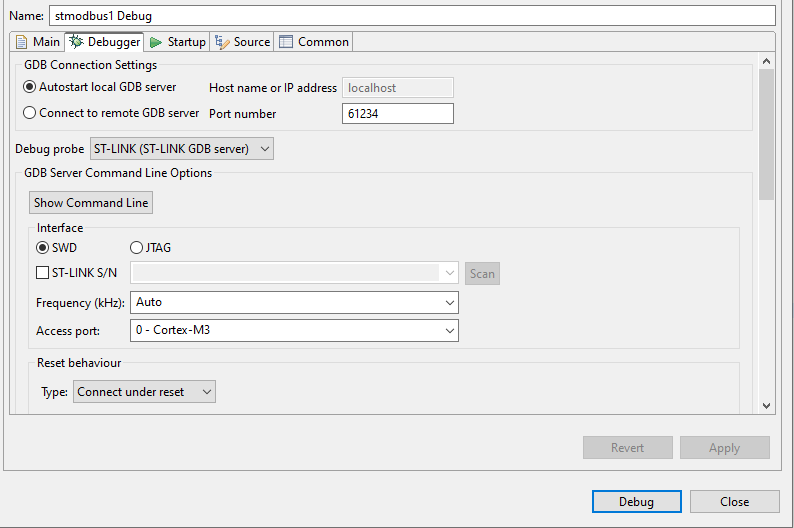

What you set in debug settings for your project ?

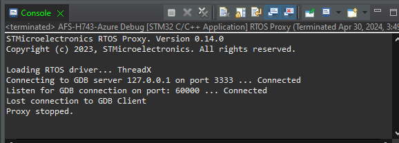

Neetu
This is my  console output.
The debug settings are
What is your st-link? The V2 stick?
Try connect: with type: software reset.
yes, The V2 stick
tried with software reset still facing the same
