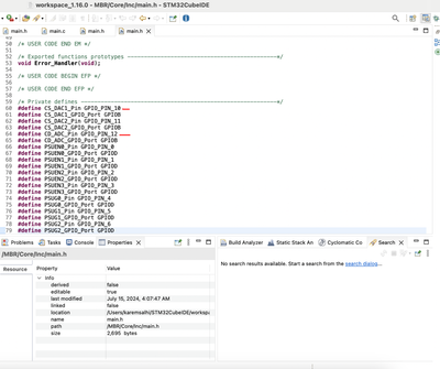

Following up from my previous post, I am having issues with code generation - it seems to complete, but I don't see anything changed in the code.
Here attached you will find the ioc file. I modified pin names for PB10 to PB12, but after generating the code I don't see any of the name in the project (should be in main.h, but I did a search in the whole project just to be sure).
I am using STM32CubeIDE 1.16.0 on mac Sonoma 14.2.1 with M1 chip.

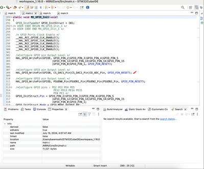

Look in main.c , gpio init :
void MX_GPIO_Init(void)
  /* GPIO Ports Clock Enable */
  __HAL_RCC_GPIOE_CLK_ENABLE();
  __HAL_RCC_GPIOC_CLK_ENABLE();
  __HAL_RCC_GPIOF_CLK_ENABLE();
  __HAL_RCC_GPIOH_CLK_ENABLE();
  __HAL_RCC_GPIOA_CLK_ENABLE();
  __HAL_RCC_GPIOB_CLK_ENABLE();
  __HAL_RCC_GPIOG_CLK_ENABLE();
  __HAL_RCC_GPIOD_CLK_ENABLE();
  HAL_GPIO_WritePin(GPIOE, GELB_Pin|GRUEN_Pin|ROT_Pin, GPIO_PIN_RESET);
There you see "your" names...after gen.code.
I don't...
Also the names should be defined in main.h, but they aren't, and they don't appear anywhere else in the project.
It just seems that my IDE is in a broken state... Unfortunately I just reinstalled it and it didn't solve the issue.
When I click generate code, the window appears but is a lot faster than it should be. It is done within a fraction of a second.

I installed CubeMX and generated the code with it. It worked, and also "repaired the CubeIDE" which is now able to generate the code... I have no idea what what went broken but I am glad it works again!
