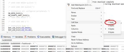

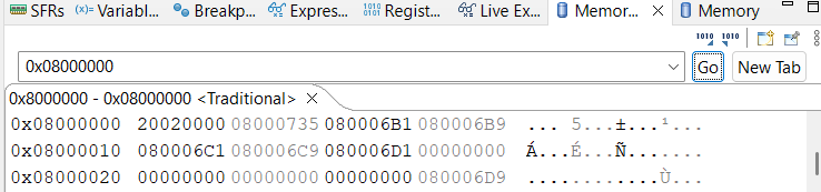

What is traditional representation of Flash content (see Figure 1 bellow) of microcontroller in the Memory Browser tab of the STM32CubeIDE?
    Figure 1:
Why does traditional representation of Flash content differ from content of .bin file (.bin file shows in the Figure 2 bellow)?
    Figure 2:
> It is possible to change little endian representation to big endian representation in the Memory Browser tab of the STM32CubeIDE.
Change cell size to 1 byte to view bytes in order.

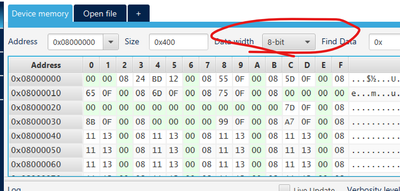

> Is it possible to change little endian representation to big endian representation in windows of the STM32CubeProgrammer?
Change data width to 8 bits if you want to view bytes in order.
It doesn't make sense to view uint32_t values in big endian because the chip is not big endian. I don't think you can force this change.

It is showing uint32_t values. The chip is little endian, so the bytes 0x01 0x00 0x00 0x00 are interpreted as a uint32_t with value 0x00000001.
Andrew Neil
The content isn't different; as @TDK said, it's just a different presentation of the same content.
