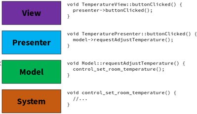

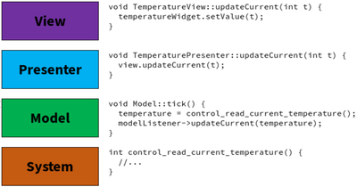

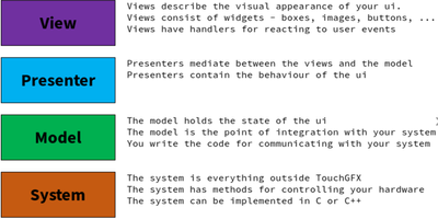

Did you respect this structure ?
From the display :
To the display :

Hello, thanks for the answer, yes, the MCU GUI communication is correct. You probably looked at my post, there is some code removed. I create a new empty project and just try to run CAN. To send and receive something. The settings are as follows and it neither sends nor receives data (callback does not work).
FDCAN is default 40Mhz, RTC -> Bypass
I would like to ask a huge request if you could send me your project by e-mail only with FdCan support, it would make it much easier for me. lcdk@lcdk.pl
