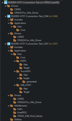

Hi there!
My goal is to use the RIVERDI example provided in Touch GFX and import it into the CubeIDE to add some peripherial features as ADC and CANFD. When the .ioc file is imported into CubeIDE all the generated folders are empty and even the .ioc file is missing despite the fact that all folders are present in the file system.
so far I 've
  • created an new  project named "RIVERDI-H757-Connection-Test" based on the Riverdi STM32 Embedded 7" Display example project provided in TouchGFX 4.32.2 Designer
  • added two screens to show the GUI is compiling (OK) and runs in the TouchGFX simulator (OK)

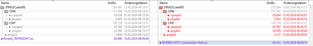

  • used this article How to clone a dual core project in STM32CubeIDE - STMicroelectronics Community provided by STM and reanmed all occureneces of "Riverdi_70STM32H7" to "RIVERDI-H757-Connection-Test"  within the
    • .ioc
    • .project
    • CM4 .project
    • CM4 .cproject
    • CM7 .project
    • CM7 .cproject files
  •  renamed  "Riverdi_70STM32H7.ioc" into "RIVERDI-H757-Connection-Test.ioc"

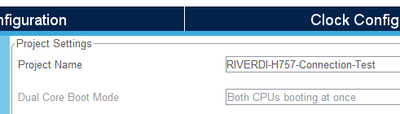

  • opened the .ioc file in CubeMX 6.10.0. changed the project name and checked the latest firmware package V1.11.2
Thanks for your help.
Cheers!

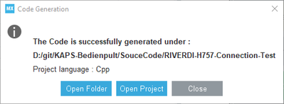

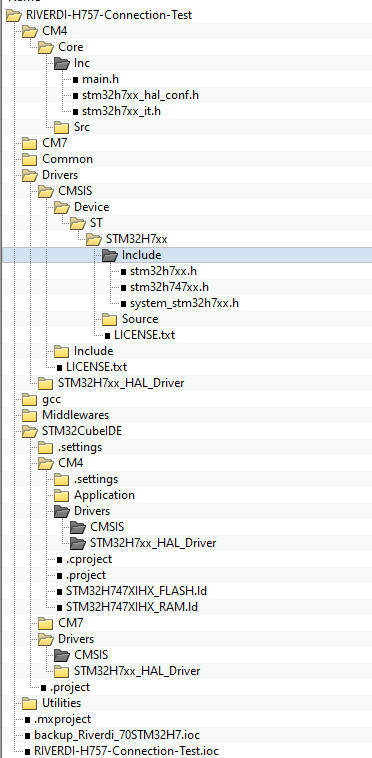

    Update
    The files are getting generated when using CubeMX only not on CubeIDE import, but the Project does not offer a "Build Project" or "Clean Project" option neither when clicking o the higher project nor on the CM4 or CM7 project. So i am unable to build ...
    Cheers!

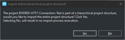

    use the CubeMX Code Generation dialog >> Open Project
    Import dialog >> Yes
    several Project extists dialog >> Yes and several Delete Resources >> OK
    and see al the files in the CubeIDE
