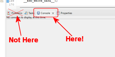

go to the very first reported error
You need to look in the build console output - not in the 'Problems' list:
"u_char" is not a standard type. Find out where you're defining it, or use standard types like uint8_t or unsigned char instead.
