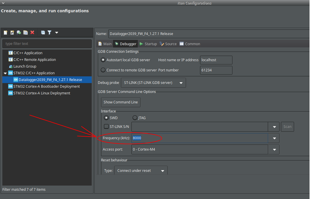

‎2023-08-17 1:45 PM
Try reverting back to version 1.12.1, this problem may be related to the ST-link frequency above 1000kHz.
