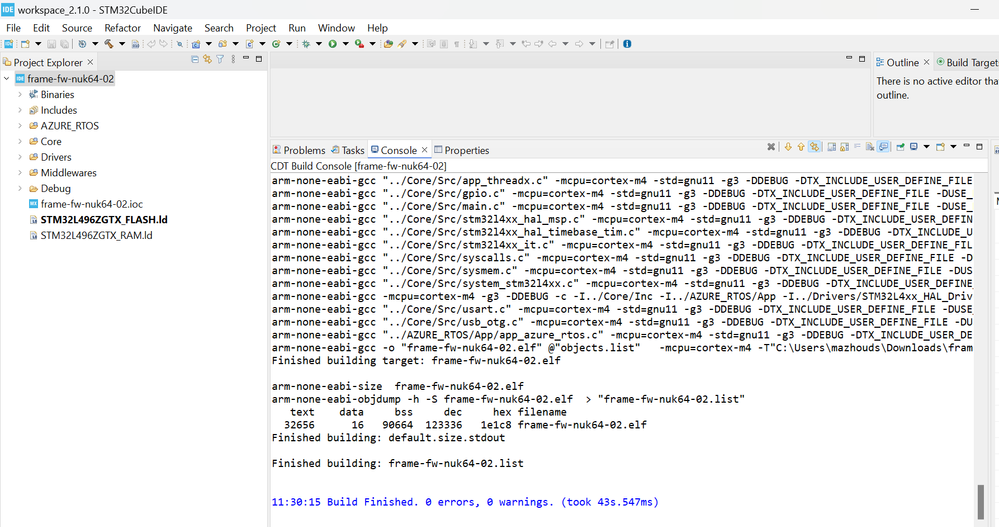

I have unrecoverable errors building on STM32CubeIDE a project generated by STM32CubeMX.
The errors arise compiling assembly .s sources for ThreadX.
Versions:
STM32CubeMX 6.17.0
STM32CubeIDE 2.1.0
Error (excerpt from build console):
arm-none-eabi-gcc -mcpu=cortex-m4 -g3 -DDEBUG -c -I../Core/Inc -I../AZURE_RTOS/App -I../Drivers/STM32L4xx_HAL_Driver/Inc -I../Drivers/STM32L4xx_HAL_Driver/Inc/Legacy -I../Drivers/CMSIS/Device/ST/STM32L4xx/Include -I../Drivers/CMSIS/Include -I../Middlewares/ST/threadx/common/inc/ -I../Middlewares/ST/threadx/ports/cortex_m4/gnu/inc/ -I../Middlewares/ST/threadx/utility/low_power/ -x assembler-with-cpp -MMD -MP -MF"Middlewares/ST/threadx/ports/cortex_m4/gnu/src/tx_thread_interrupt_disable.d" -MT"Middlewares/ST/threadx/ports/cortex_m4/gnu/src/tx_thread_interrupt_disable.o" --specs=nano.specs -mfpu=fpv4-sp-d16 -mfloat-abi=hard -mthumb -o "Middlewares/ST/threadx/ports/cortex_m4/gnu/src/tx_thread_interrupt_disable.o" "../Middlewares/ST/threadx/ports/cortex_m4/gnu/src/tx_thread_interrupt_disable.S"
../Middlewares/ST/threadx/ports/cortex_m4/iar/src/tx_misra.s: Assembler messages:
../Middlewares/ST/threadx/ports/cortex_m4/iar/src/tx_misra.s:25: Error: bad instruction `extern __aeabi_memset'
../Middlewares/ST/threadx/ports/cortex_m4/iar/src/tx_misra.s:26: Error: bad instruction `extern _tx_thread_current_ptr'
../Middlewares/ST/threadx/ports/cortex_m4/iar/src/tx_misra.s:27: Error: bad instruction `extern _tx_thread_interrupt_disable'
../Middlewares/ST/threadx/ports/cortex_m4/iar/src/tx_misra.s:28: Error: bad instruction `extern _tx_thread_interrupt_restore'
../Middlewares/ST/threadx/ports/cortex_m4/iar/src/tx_misra.s:29: Error: bad instruction `extern _tx_thread_stack_analyze'
../Middlewares/ST/threadx/ports/cortex_m4/iar/src/tx_misra.s:30: Error: bad instruction `extern _tx_thread_stack_error_handler'
../Middlewares/ST/threadx/ports/cortex_m4/iar/src/tx_misra.s:31: Error: bad instruction `extern _tx_thread_system_state'
../Middlewares/ST/threadx/ports/cortex_m4/iar/src/tx_misra.s:41: Error: bad instruction `public _tx_misra_always_true'
../Middlewares/ST/threadx/ports/cortex_m4/iar/src/tx_misra.s:42: Error: bad instruction `public _tx_misra_block_pool_to_uchar_pointer_convert'
../Middlewares/ST/threadx/ports/cortex_m4/iar/src/tx_misra.s:43: Error: bad instruction `public _tx_misra_byte_pool_to_uchar_pointer_convert'
../Middlewares/ST/threadx/ports/cortex_m4/iar/src/tx_misra.s:44: Error: bad instruction `public _tx_misra_char_to_uchar_pointer_convert'
I have attached the .ioc file.
The project name can be misleading, the target is NUCLEO-L496ZG board, which has a 144-pin microcontroller.

I am checking this behavior internally, what version of toolchain have you used?
KR, Souhaib
as i posted
STM32CubeMX 6.17.0
STM32CubeIDE 2.1.0
STM32Cube FW_L4 V1.18.2
ThreadX version 6.2.0
Hello @Adriano Melis
Using your ioc and building with STM32CubeIDE 2.1.0, I was not able to reproduce the issue:
KR, Souhaib
