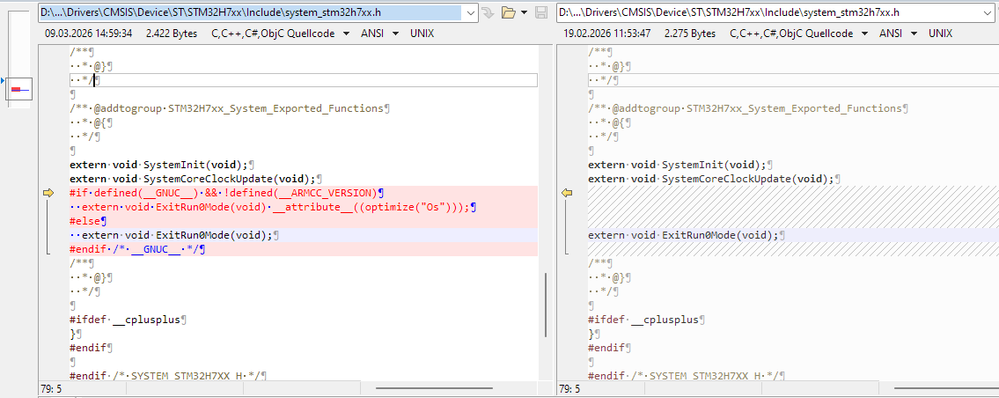

we get now following warning if a file is including the header
\Drivers\CMSIS\Device\ST\STM32H7xx\Include\system_stm32h7xx.h
[build] [6/206] Building C object CMakeFiles/STM32_NUCLEO-H753ZI.dir/AZURE_RTOS/App/app_azure_rtos.c.obj
[build] In file included from D:/dev/Prj/Clean_STM32H7_Project__02/AZURE_RTOS/App/app_azure_rtos.c:28:
[build] In file included from D:/dev/Prj/Clean_STM32H7_Project__02/cmake/stm32cubemx/../../Drivers/CMSIS/Device/ST/STM32H7xx/Include/stm32h7xx.h:124:
[build] In file included from D:/dev/Prj/Clean_STM32H7_Project__02/cmake/stm32cubemx/../../Drivers/CMSIS/Device/ST/STM32H7xx/Include/stm32h753xx.h:232:
[build] D:/dev/Prj/Clean_STM32H7_Project__02/cmake/stm32cubemx/../../Drivers/CMSIS/Device/ST/STM32H7xx/Include/system_stm32h7xx.h:88:49: warning: unknown attribute 'optimize' ignored [-Wunknown-attributes]
[build]    88 |   extern void ExitRun0Mode(void) __attribute__((optimize("Os")));
[build]       |                                                 ^~~~~~~~~~~~~~
[build] 1 warning generated.
Comparing the versions of system_stm32h7xx.h shows following:
We use the "CMake" and "ST Arm Clang" settings in STM32CubeMX
under "Project Manager / Project / Default Compiler / Linker".
After generating the project we open the folder with VSCode with active STM32CubeIDE Extension.
But clang can not work with the new  __attribute__((optimize("Os")) but defines the __GNUC__ macro for compatibility reasons. Therefore we get a warning.
@st Please solve this issue - Thanks
Bet regards Timo

Since clang by default pretends to be GCC and defines __GNUC__ ...
#if defined(__GNUC__) && __has_attribute(optimize)
Opened issue on github.
Thanks.
Julien D
The optimize attribute is a GNU attribute and is not supported by Clang.
However, in system_stm32h7xx.h, the check for using this attribute is based on __ARMCC_VERSION, which is defined only for ARM compilers. Waiting for a fix you could also insert this check: !defined(__clang__).
Proposed a fix via github issue, against cmsis-device-h7 release 1.10.7  here.
Use the standard preprocessor function __has_attribute rather than check for specific compilers.
