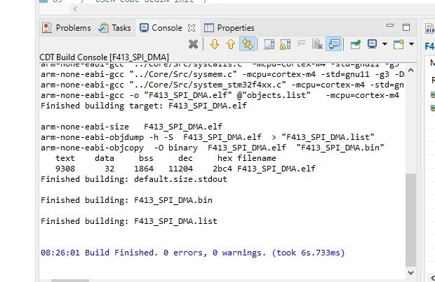

I've created a project that has created an elf file:

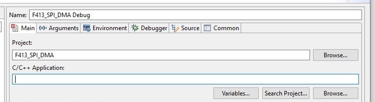

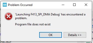

However, when I run debug on STM32CubeIDE I get the following message:
Can anyone advise, please? I've not had this problem before with STM32G071, but am trying with STM32F413.
Thanks
Guru
Go into Run -> Debug Configurations... and make sure it's pointing to the right ELF in the "C/C++ Application" field. Hit "Search Project" and ensure it exists.

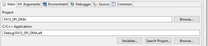

I'm working in Debug mode and got STM32CubeIDE to accept the ELF.
The first step was indicated by TDK by (Run -> Debug Configurations...) [note: ensure that CubeIDE only has one project open, the one that is requiring this modification].
This showed 'C/C++ Application' being empty:

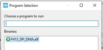

0693W00000FARYAQA5.jpgPressing 'Search Project...' gave the following:
0693W00000FARYoQAP.jpgDouble clicking on the ELF filled in the missing file:
