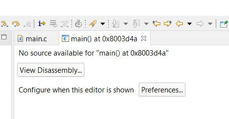

I am using STM32f413zh i build the code in release mode. After that i put break points on inside the code some places, None of the break point is hit. But i flash the binary file the code was running. Please give guidance for hit the code on main() or inside the code.

So the debugger won't know what code addresses correspond to which source lines - as discussed above.
If you want to be able to do source-level debug, then you need to enable the debug info.

One reason for this could be that the release mode uses a different code optimisation, so that the lines with the break points have been optimised away. They are then still in the source code, but no longer play a role for the code execution.

If you're in Release mode, is debug information being created?
Yes, I pause the code while running that was not reach any error handlers, The code was running properly i am also able to see the led indications also perfectly run as per logic.
While i debug the code i am able to see the below screen. I don't know why that was not hit in inside main().
again, If you're in Release mode, is debug information being created?
NO.
