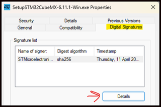

Does ST publish hashes for its install packages, enabling one to check whether an archived (say) Cube IDE 1.14.1 has been corrupted?
The reason for asking is that I am developing a product for a customer and may have to send him a version which is no longer on the ST website, and he is likely to have trust issues with that.

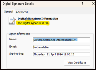

    Full installers (.exe files) for Windows are signed and Windows itself can verify the signature:
    So this is all the user wants or needs.

    Thank you Pavel. I guess that is sufficient.
    Unfortunately the x.x.0 versions are usually not usable - e.g. 1.15.0 breaks the debugger and other stuff, but ST are keeping only these x.x.0 versions on their website, and only for a while. So I would have to archive the one I want to keep, and rely on the signature.
