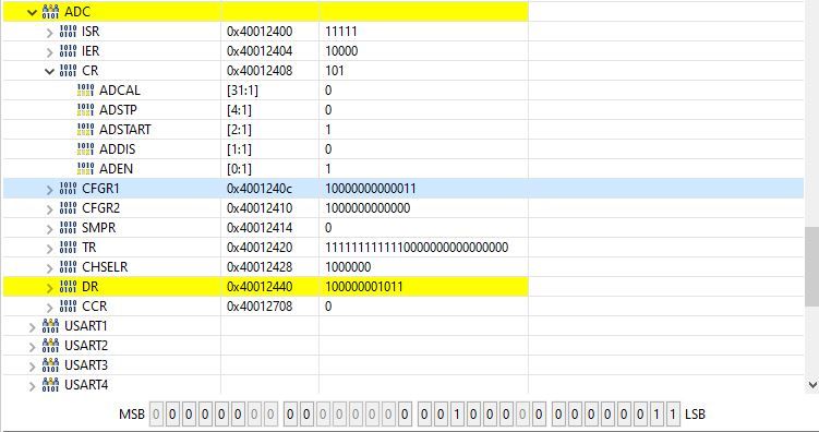

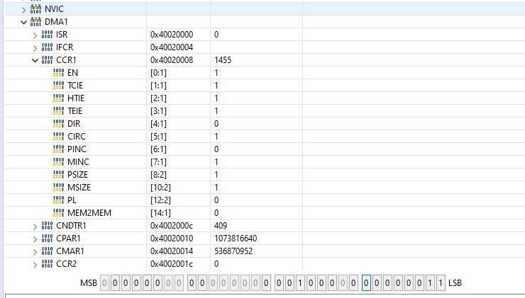

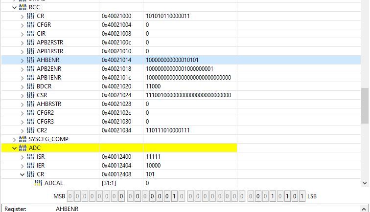

I dug into the registers to get some screenshots. If I toggle the enable bit in the DMA_CCR1 register, the DMA seems to transfer an arbitrary number ~(10-100) of ADC reads but then freezes up again... It turns out that if I keep toggling the enable bit, it eventually gets to the halfway mark and the interrupt triggers. So the issue is not the interrupts triggering, but that the DMA isn't 'running'. (This behaviour occurs if I toggle other DMA registers, but does not occur if I toggle values in other registers)
This leads me to believe its a clock issue, but I think the clocks are all correctly setup.
I can use the debugger to read the ADC reads in the buffer array and the ADC does read valid results when it 'works' (that is when I'm toggling a bit in a DMA register as I mentioned above)
Here are the screenshots for DMA, ADC and RCC registers:

Read out and check/post the ADC and DMA registers content.
Hi JW,
I have edited my post to include those. Interestingly it appears the issue is not that the callbacks don't fire, but rather that the DMA doesn't seem to be running (DMA_CNDTR1 register remains constant).
Hi there,
Thanks for the pointers!
I had a dig, but before I got too deep, experimenting showed me that the issue is actually occurring at a higher level. The DMA doesn't appear to be running, indicated by DMA_CNDTR1 register remaining constant. (My posted has been edited to explain how I determined this)

So I have narrowed the problem further.
It seems that the ADC is being over-run.If I change the ADC clock source to 'synchronous clock mode' the code works fine, but if I use asynchronous there ADC is overrun and the DMA freezes up.
I'm not sure why this is happening? At least the code does work now... but I am curious as to why the asynchronous mode causes problems.
waclawek.jan
I'm lazy to decipher the registers, and don't know your RCC/clocks settings anyway. So, what's your ADC sample rate in both cases, and compare that to system/APB frequencies.
Also, is there any other DMA or any code accessing peripherals on the same bus as ADC is?
JWyli.1
So I think I've figured it out.
The issue was my clock configuration. I was using 8MHz to clock the DMA peripheral, while using the asynchronous internal 14MHz clock source for the ADC. Hence why the ADC kept getting over-run and why the DMA ultimately kept freezing up.
