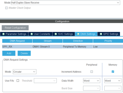

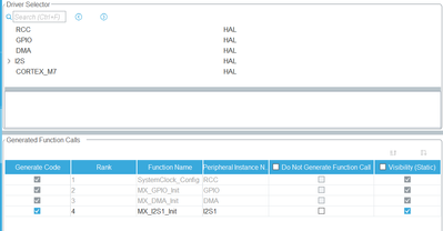

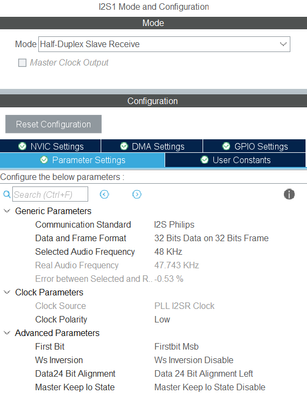

I'm debugging H723 with CUbeIDE1.14.0,but the generated code does not work.
no interrupt happened.

1.disable DMA
2.set I2S as half-duplex master transmit,it can send data out
3.set I2S as half-duplex slave receive,it can not receive data.
Hello @Binge,
If you need to use interrupt process, you should configure the I2Sx interrupt priority and enable the NVIC I2S IRQ handle.
If you need to use DMA process:
Declare a DMA handle structure for the Tx/Rx Stream/Channel.
◦ Enable the DMAx interface clock.
◦ Configure the declared DMA handle structure with the required Tx/Rx parameters.
◦ Configure the DMA Tx/Rx Stream/Channel.
◦ Associate the initialized DMA handle to the I2S DMA Tx/Rx handle.
◦ Configure the priority and enable the NVIC for the transfer complete interrupt on the DMA Tx/Rx
Stream/Channel
You can learn more about the HAL_I2S_Receive_DMA() function on the User Manual:
 Description of STM32H7 HAL and low-layer drivers - User manual.
Thanks.
Attachment is my project,please check it for me,I really can't find the problem.
