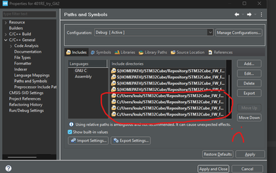

My issue is that I do not want STM32 CubeIDE to add new includes in the Paths and Symbols's include directories when I am clicking Device Configuration Tool Code Generation.
Every time I click on Device Configuration Tool Code Generation ( DCTCG ),  CubeIDE add these directories,
C:/Users/louis/STM32Cube/Repository/STM32Cube_FW_F4_V1.27.1/Drivers/STM32F4xx_HAL_Driver/Inc
C:/Users/louis/STM32Cube/Repository/STM32Cube_FW_F4_V1.27.1/Drivers/STM32F4xx_HAL_Driver/Inc/Legacy
C:/Users/louis/STM32Cube/Repository/STM32Cube_FW_F4_V1.27.1/Drivers/CMSIS/Device/ST/STM32F4xx/Include
C:/Users/louis/STM32Cube/Repository/STM32Cube_FW_F4_V1.27.1/Drivers/CMSIS/Include

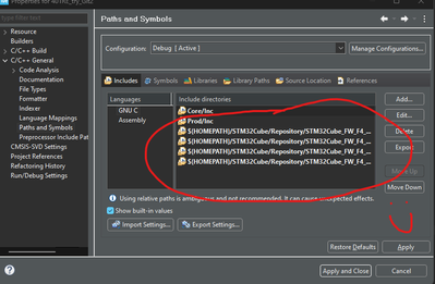

What I want instead is :
${HOMEPATH}/STM32Cube/Repository/STM32Cube_FW_F4_V1.27.1/Drivers/STM32F4xx_HAL_Driver/Inc
${HOMEPATH}/STM32Cube/Repository/STM32Cube_FW_F4_V1.27.1/Drivers/STM32F4xx_HAL_Driver/Inc/Legacy
${HOMEPATH}/STM32Cube/Repository/STM32Cube_FW_F4_V1.27.1/Drivers/CMSIS/Device/ST/STM32F4xx/Include
${HOMEPATH}/STM32Cube/Repository/STM32Cube_FW_F4_V1.27.1/Drivers/CMSIS/Include
I do not want the absolute paths because I want the cloning process to be easy with github. ${HOMEPATH} is enabling to do so but I do not want CubeIDE to add every colleagues's includes paths
