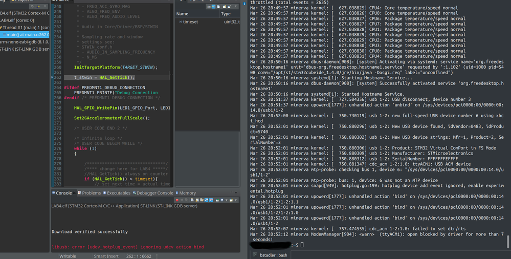

When trying to use the debug function in CubeIDE on Linux I get an udev related error. It works most of the time, but at some functions it stops and the debugger drops out. See below for technical details as well as a workaround.
Details
OS: Kubuntu 18.04
Kernel Version: 4.15.0-140-generic
Error in CubeIDE (v1.1.6): `libusb: error [udev_hotplug_event] ignoring udev action bind`
udev Version: 10.45
Board: STEVAL-STWINKT1
Debugger: STLINK-V3MINI
See attached screenshot of syslog and cubeIDE:
Workouround
Disabling the udev service via systemctl fixes the issue, using this example bash script:

Of course this is only a workaround. In general one does not want to disable udev.
